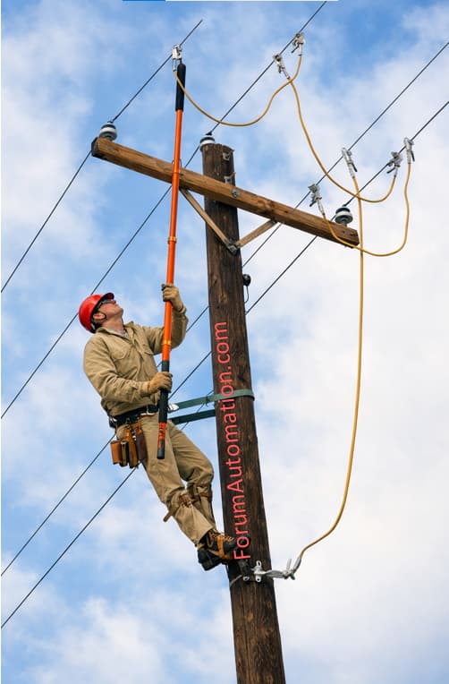

Disconnecting the lines safely requires following certain protocols.
• Use the test stick to ensure that no effort is applied to the split line.
• Discharge the magnetic-induced charge line.
• Temporary grounding (ground + short) prior to entering the work area.
• Adding another temporary grounding point after the work area.
Why are we connecting grounding before and after the work area?
• Avoid accidentally returning the feeder.
• Protects against the functioning of the disconnected line as a result of the station controllers mistake (or) forgetfulness.
• Complete discharge of the induced voltage.
• Ensures that all voltage generated across the separated line & on both sides is discharged.
• Secure the whole work area.
• Protects technicians from electricity from nearby transformers, homes or generators.
• Back-up protection line.
If one of the groundings fails for whatever reason the other grounding guarantees that the line is properly protected.
Technicians laboring to maintain the electrical network.
