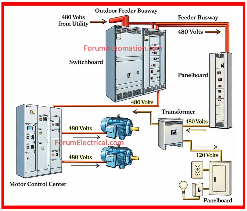

MCC stands for Motor Control Center which is a floor mounted assembly for motor control. The MCC contains all the motor control units, feeders for the motors and blowers. They are specially designed for different motor ratings and they are available in automatic and manual operation.
An MCC is a steel structure that contains the combination of engine control units, raceways, internal wiring and busbars. A vertical section can be independent as a complete motor control centre, or several sections can be screwed and transported together.
The MCC is connected with PLC/DCS control panels, for that large quantity of cabling and connections was necessary in conventional MCC. But it is less needed with latest smart MCCs. It receives a digital signal from the control panel and also can be operated by the field operators remote mode. The MCC produce the control action for the motor in response to the digital input.
The MCC links the digital controller with the analog field actuators. The MCC contains timers, counters, for the necessary operations.
