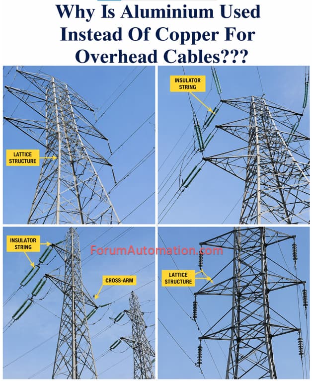

The characteristics of overhead lines determine the use of Aluminium wires.
For overhead lines, you will know that the wires are hung in the air by means of poles or towers. There are specifications for the weight of the wires since overhead circuit cables are hanging in the air.
Aluminium actually has the second-highest conductivity, behind copper.
Aluminium’s conductivity is roughly two-thirds that of copper, while its density is only one-third that of copper.
As a result, in the overhead state, Aluminium wire is preferable.
Outdoor wires are also affected by their own gravity and environmental influences.
The simplest point, for example, will be impacted by changes in air and temperature, which is our ordinary thermal expansion and contraction.
The ability of the Aluminium wire to withstand thermal expansion and contraction is better than that of copper wire, so it is more suitable to use Aluminium wire for overhead wires.
