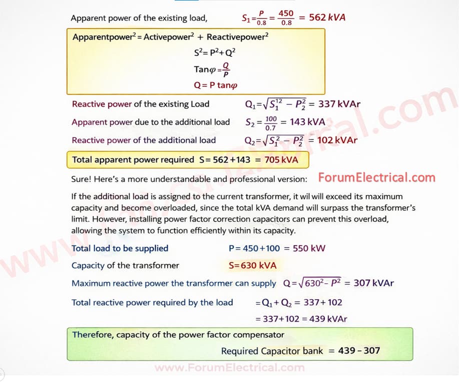

Example:
An industrial plant is supplied with power through a
Transformer with a capacity of 630 kVA and a voltage of 11kV/433V. The current load is 450 kW, with an average power factor of 0.8 (lagging). Adding a load of 100 kW with a power factor of 0.7 may require increasing the transformer’s capacity.
The research failed to compensate for temporary overloading induced by load changes.
