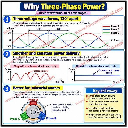

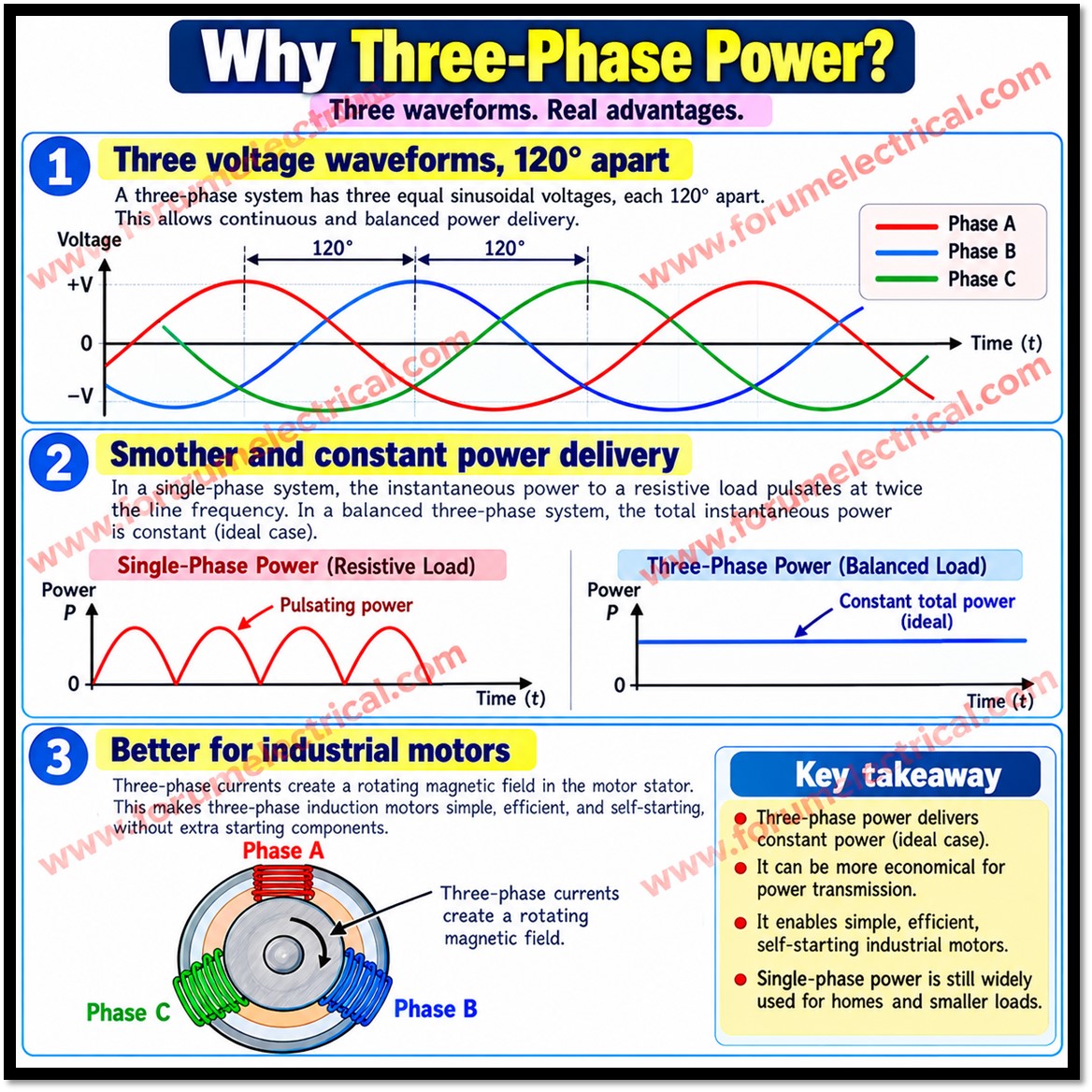

Three main reasons:
1). Smoother Power Delivery
Balanced three-phase power provides constant total instantaneous power under ideal conditions.
2). Less Conductor Material
Three-phase transmission can deliver the same power more economically.
3). Better Motor Operation
Three-phase currents naturally create a rotating magnetic field, making industrial motors simpler and easier to start.
Single-phase power is perfectly practical for many household loads.
But for large-scale power systems and industrial machinery, three-phase power offers major advantages.
