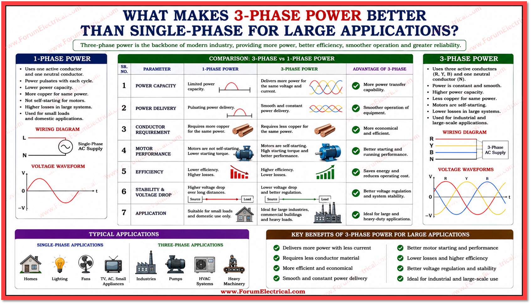

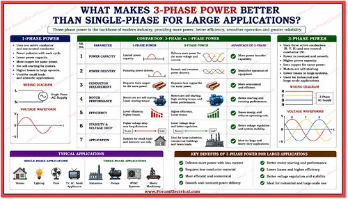

3-phase power is preferred for the large industrial and commercial applications since it delivers more power efficiently which provides smoother operation and reduces equipment size and operating costs.
Primary Advantages of 3-Phase Power
1). A 3-phase system may transmit significantly more power than a single-phase system utilizing the same conductor size.
2). Ideal for heavy loads such as motors, transformers, compressors & industrial machinery.
3). In a 3-phase system power is delivered continuously rather than pulsating as in a single-phase system.
4). This results in smoother and more stable equipment operation.
5). 3-phase motors are self-starting and generate a uniform rotating magnetic field.
6). They provide higher starting torque, smoother operation and better efficiency.
7). For the same power output a 3 phase system needs less conductor material than an equivalent single-phase system. This reduces installation costs.
8). Lower transmission losses and improved power utilization make the 3-phase systems more energy efficient.
9). 3-phase systems maintain a better voltage regulation over a long distances and under heavy loads.
10). Motors, generators & transformers designed for 3-phase systems are generally smaller and lighter for the same power rating.
A small house typically uses single-phase power for lighting, fans and appliances.
A factory operating large motors, pumps, HVAC systems, welding machines, and compressors uses 3-phase power because it used to handle high power demands efficiently and reliably.
3-phase power is better than single-phase power for large applications because it delivers more power with
  • Higher efficiency,
  • Lower losses,
  • Smoother motor operation,
  • Better voltage regulation,
  • Reduced equipment and
  • Wiring costs.
This is reason industries, commercial buildings and power transmission systems predominantly use 3-phase electrical systems.
