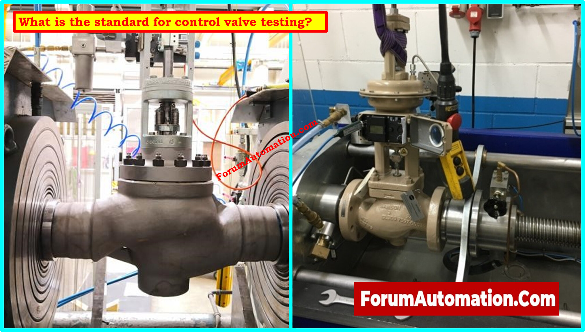

Testing control valves is an important step in making sure that they work properly, safely, and in line with industry standards. govern valves must be tested according to well-known international standards since they directly govern flow, pressure, and process stability.
Some of the most used standards for evaluating control valves are: API 598 (American Petroleum Institute) talks about checking valves, measuring their pressure, and verifying their function. It makes sure that valves can handle the right amount of pressure and keep working without leaking.
ISO 5208 (International Standard) explains how to test valves for pressure, including high-pressure and performance testing. People all across the world use it for both control and isolation valves.
MSS SP-61 (Manufacturers Standardization Society) — This standard is mostly about testing valves for hydrostatic shell leaks and seat leaks.
ANSI/FCI 70-2 talks about how to classify control valve seat leaks. This is a common reference in process industries.
NAMUR NE 107 sets the standards for how control valves and smart positioners should work together and how they should be able to talk to each other. This makes sure that digital integration with process control systems is always the same.
These guidelines tell you how to do a visual examination, a hydrostatic test, check for seat leakage, check for functional response, and check for shutdown capability. Testing control valves in real life requires getting ready, looking them over, checking for leaks, running tests, and writing down what you find.
By following these rules, both end-users and producers may make sure that the valves are safe, work well, meet all regulations, and last longer. Engineers need to choose the right testing standard based on how important the process is, whether it’s for oil and gas, chemicals, power, or water treatment.
