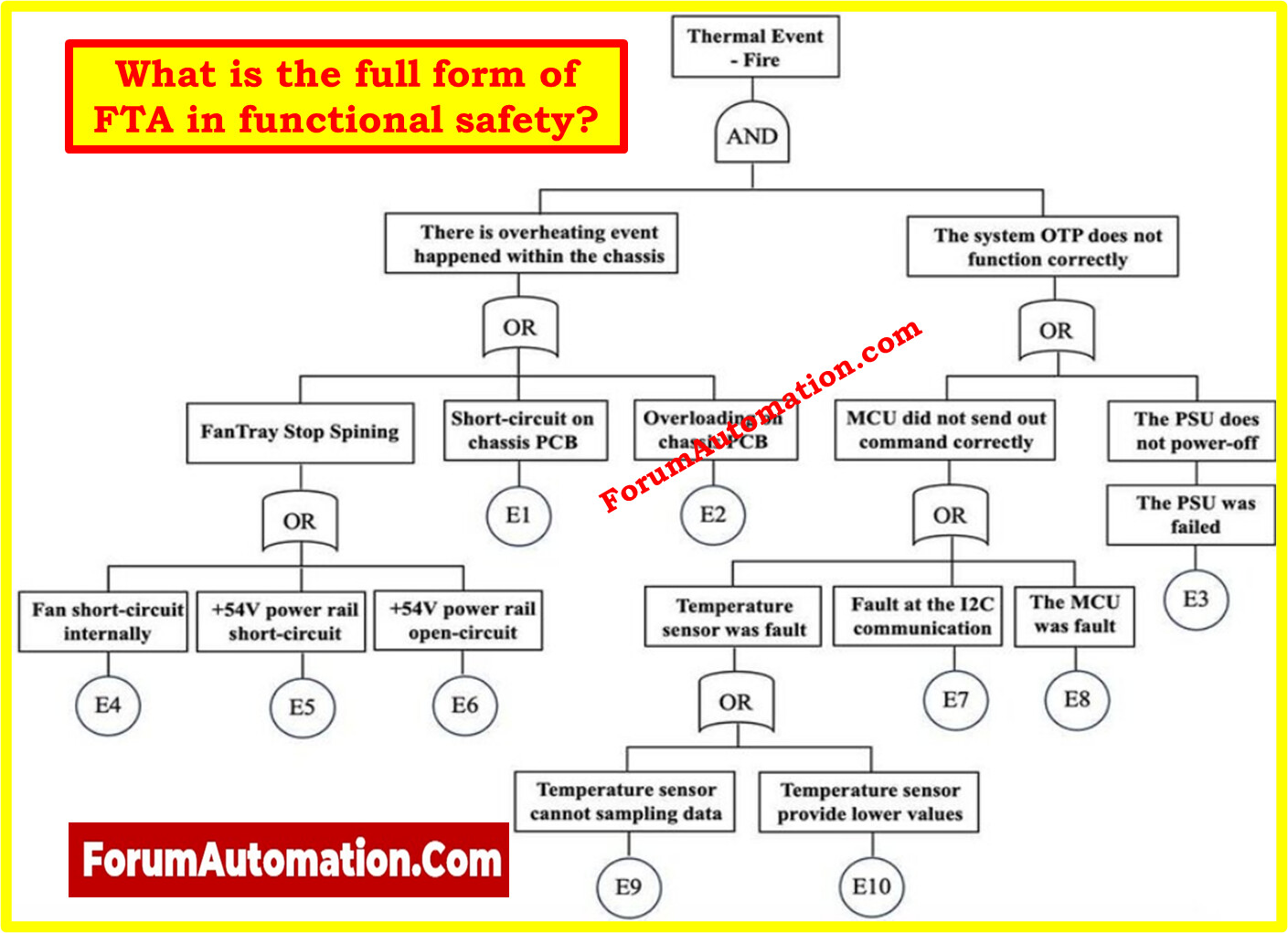

In the context of functional safety, FTA stands for Fault Tree Analysis. It is an organized, logical method for figuring out what might have caused a system-level failure and how those causes could work together to trigger dangerous occurrences.
What is Fault Tree Analysis (FTA)?
A tree-shaped figure shows FTA. The “Top Event” is at the top and is the failure that you don’t want, such when the brakes in a car system are applied by mistake. The branches below it show the numerous things that could have caused this event. Engineers use logical operators like AND, OR, and priority gates to figure out how lesser problems with hardware, software, or the environment can come together to cause the hazard.

  • Emphasizing minimal cut sets, which are the fewest number of defects that might generate the hazard.
For instance, in ISO 26262 automotive compliance, FTA helps figure out the ASIL (Automotive Safety Integrity Level) by figuring out the chances of hardware failure and suggesting ways to make designs better.
