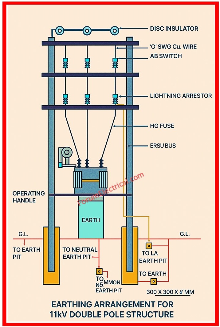

What is the Earthing Arrangement for an 11kV Double Pole Structure?
Earthing is necessary for assuring the safety of electrical systems and the dependability of the system. Let’s have a look at the most important components and the earthing connections between them:
Primary Components
Disc Insulator
Insulation & mechanical support are also things that it provided.
AB Switch
For the purpose of safely disconnecting the circuit.
Lightning Arrestor (LA)
Specifically, it protects the device from surges of high voltage.
HG Fuse
In order to offer protection against overcurrent.
Earth Bus
This connects a number of different earthing locations.
Operating Handle
Operating Handle for the purpose of manually operating the switchgear.
Base Plate 300 × 300 × 6 mm
Support for the structure is provided by it.
Earthing Connections
Earth Pit
Earth Pit in order to guarantee a secure and efficient grounding.
Neutral Earth Pit
Neutral Earth Pit in order to supply neutral grounding that is dedicated.
LA Earth Pit
LA Earth Pit is used when lightning surges are discharged in a safe manner.
Common Neutral & Body (N&B) Earth Pit
Common Neutral & Body (N&B) Earth Pit with the purpose of providing shared earthing for the neutral & equipment body.
