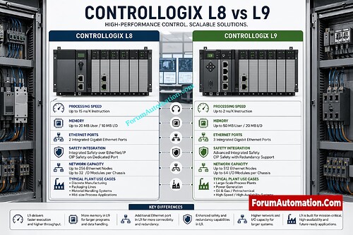

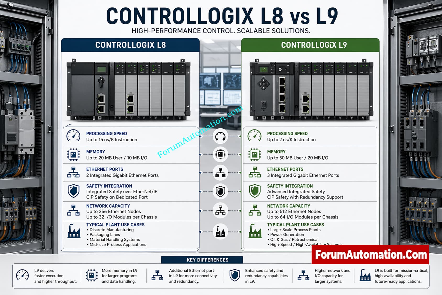

Basic difference
L8 is part of the ControlLogix 5580 family, and L9 is part of the newer ControlLogix 5590 family. The L8 platform is built for high-performance control and has a 1-gigabit integrated Ethernet connector and up to 45% more capacity than older models. The L9 platform goes even farther by adding more memory for users, faster scan times, better communication, and built-in safety features.
Hardware and capacity
From the perspective of a plant engineer, the L9 family is designed for larger and more interconnected systems. Rockwell’s documentation say that L9 controllers have two built-in Ethernet connectors, a USB Type C interface, and memory options that go up to 80 MB standard and 12 MB safety on the higher variants. The 5580 family, on the other hand, has one built-in Ethernet port and is already set up for current I/O, motion, and safety applications, although it doesn’t have as much headroom as the 5590 line.
How to choose in real projects
If the application is a normal upgrade, migration, or medium-sized process system and the current architecture is stable, use L8. If the project needs additional memory, better network connectivity, tighter safety integration, or a stronger platform for future growth, choose L9. L9 is frequently the preferable choice for plants that want to combine controllers, make panels less complicated, and support more demanding multidiscipline control.
