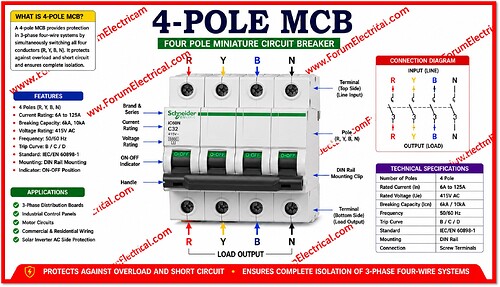

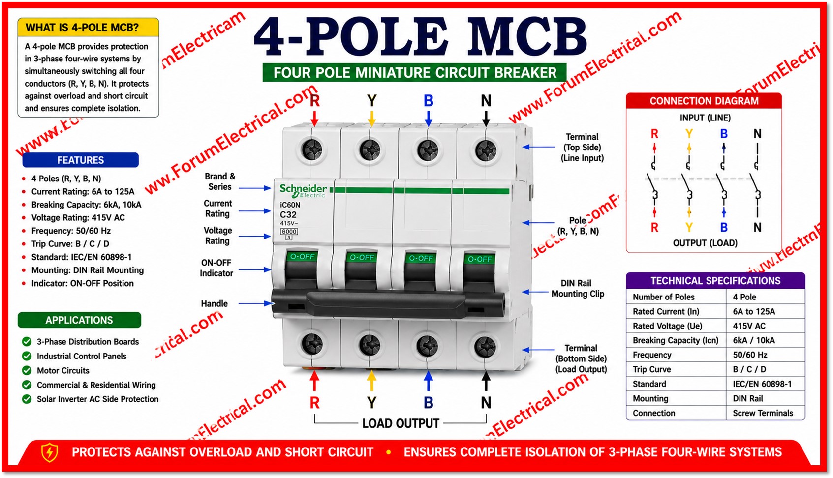

Why is 4-pole MCB used?
In three-phase electrical systems, a 4-pole MCB is utilized to properly separate and safeguard the neutral wire as well as the three live phase conductors. It eliminates floating neutral dangers, regulates unbalanced loads, and guarantees complete circuit shutdown in maintenance (or) faults.
