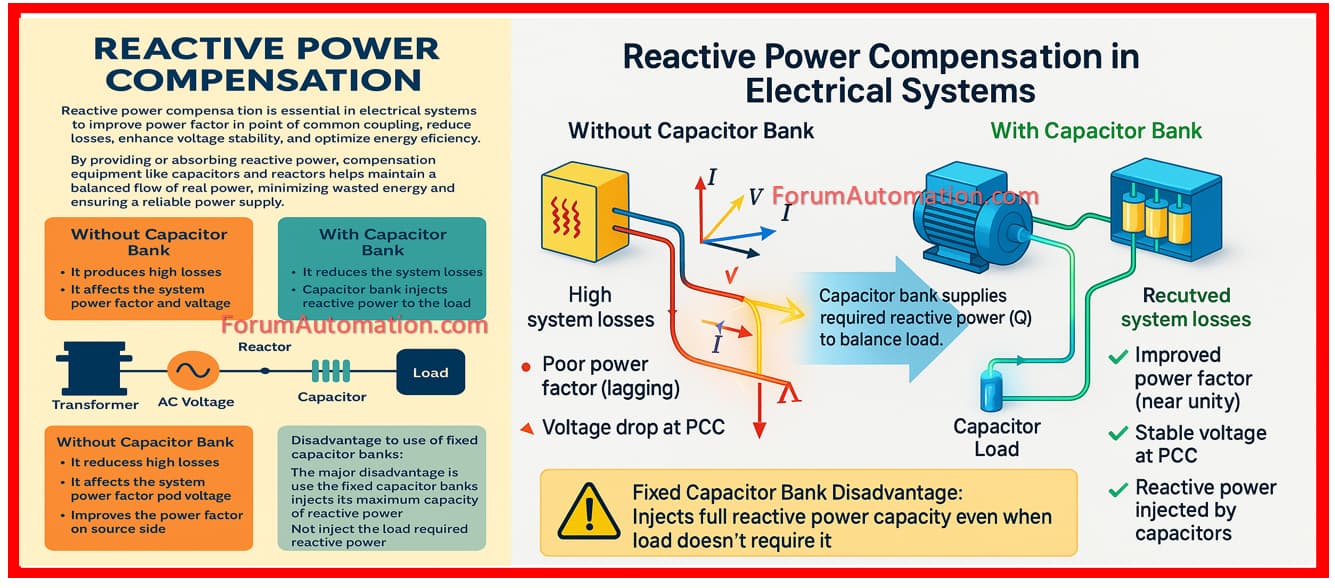

Without Capacitor Bank
Without a capacitor bank, large losses occurs affecting the system’s power factor and also voltage.
With Capacitor Bank
The capacitor bank lowers system losses.
The capacitor bank injects reactive power to the load and improves the power factor on the source side.
The primary disadvantage of using fixed capacitor banks is that they only inject the maximum amount of reactive power not the required amount.
