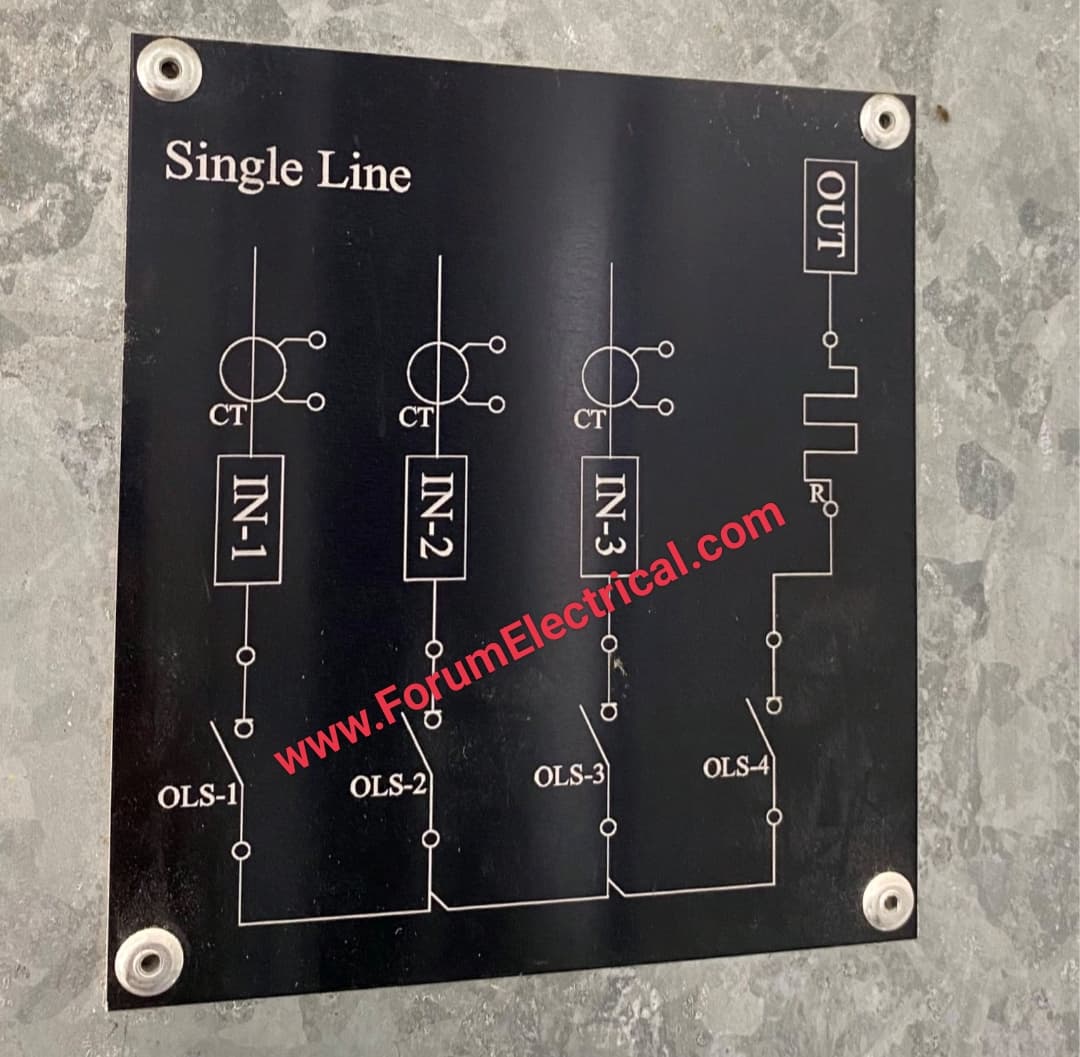

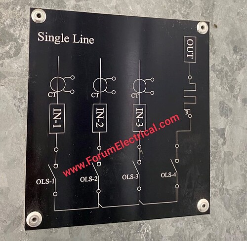

Neutral Earthing Resistor (NER)
Technically, it is a bank of resistor elements made of stainless steel covered by a metal enclosure. It is connected between the Neutral of a power source and the Earth grid.
(NER) is also known as a Neutral Grounding Resistor (NGR), is a safety device used in electrical power systems to limit the current that flows during a ground fault.
