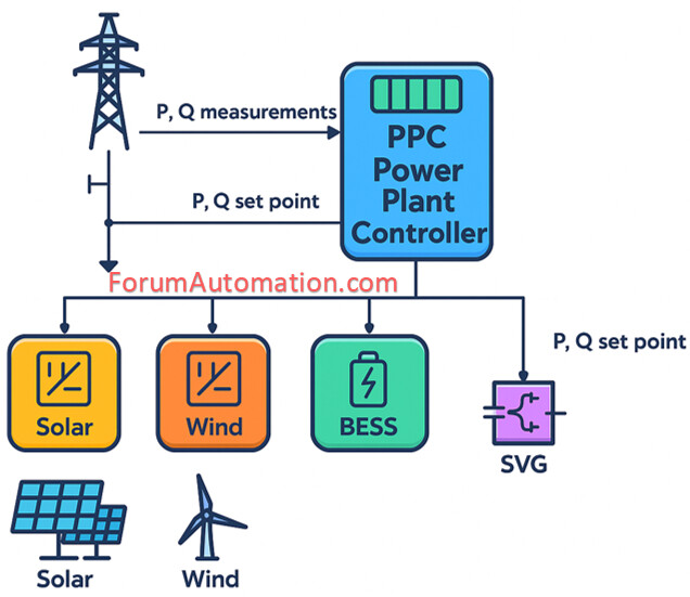

[color=#ff0000]What is a Power Plant Controller (PPC)? [/color]
As renewable energy systems improve and integrate with modern grid requirements, the Power Plant Controller (PPC) becomes increasingly important in guaranteeing dependable and efficient operation.
The PPC located at the center of
• Utility-scale PV, wind,
• Battery energy storage systems (BESS) and
• Hybrid facilities
serves as the power plant’s brain coordinating smoothly with grid operators to ensure stability and compliance.
[color=#ff0000]Why is it Important? [/color]
The PPC dynamically controls active & reactive power regulates voltage & power factor at the Point of Connection (PoC) & helps to stabilize frequency during grid occurrences.
It also controls the transition between day and night modes, interfaces with SCADA systems & responds to utility requests in real time.
The PPC optimizes energy flow, assures grid compliance, and responds quickly to operational demands by connecting with inverters & power quality meters.
Finally, the PPC provides exact monitoring, processing & control every second, which makes it necessary in current renewable energy plants.
[color=#ff0000]Advantages of Power Plant Controller (PPC) [/color]
  1. Dynamic active and reactive power control,
  2. Voltage and power factor adjustment at the point of connection (POC),
  3. Frequency support during grid activities,
  4. Day/night mode management,
  5. Integration with SCADA systems & utility orders and
  6. Interfaces with inverters & power quality meters (PQM).
