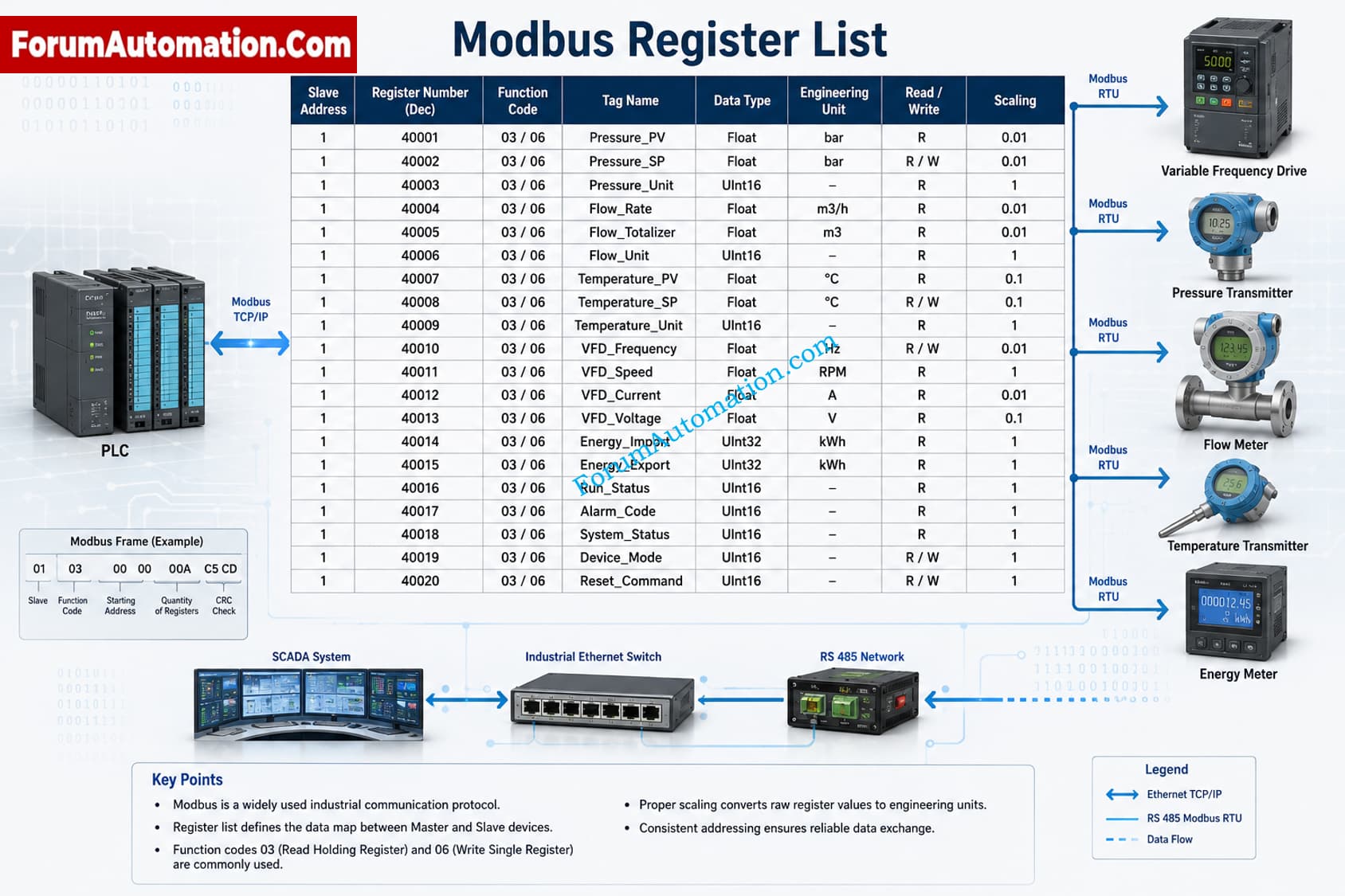

Understanding a Modbus List
A Modbus list is a tabular structure of all communication points exchanged between one or more Modbus slave units and one Modbus master. It is the communication reference for industrial automation systems engineering, commissioning, troubleshooting and maintenance.
A Modbus list makes ensuring that each device is reading or writing the correct data and avoids addressing conflicts or setup mistakes.
Typical Information Included
A Modbus list generally contains:
  • Device name
  • Slave address
  • Register address
  • Register type
  • Data description
  • Data format
  • Read or write access
  • Scaling factor
  • Engineering unit
This document is often developed in detail in engineering and verified in factory acceptance testing and site commissioning.
