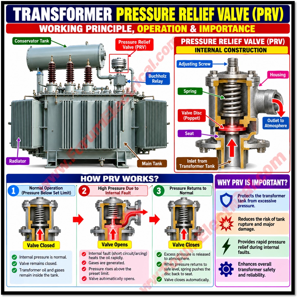

A transformer PRV is a vital safety device designed to protect an oil-filled transformer from excessive internal pressure.
How does it work?
During a serious internal fault, such as a short circuit or arcing, the transformer oil can heat up rapidly. This can generate gases and cause a sudden increase in internal pressure.
When the pressure exceeds the PRV’s preset operating limit, the valve automatically opens and releases the excess pressure.
Once the pressure returns to a safe level, the valve closes again.
Why is PRV important?
  1. Protects the transformer tank from excessive pressure.
  2. Reduces the risk of tank rupture and major damage.
  3. Provides rapid pressure relief during internal faults.
  4. Enhances overall transformer safety and reliability.
