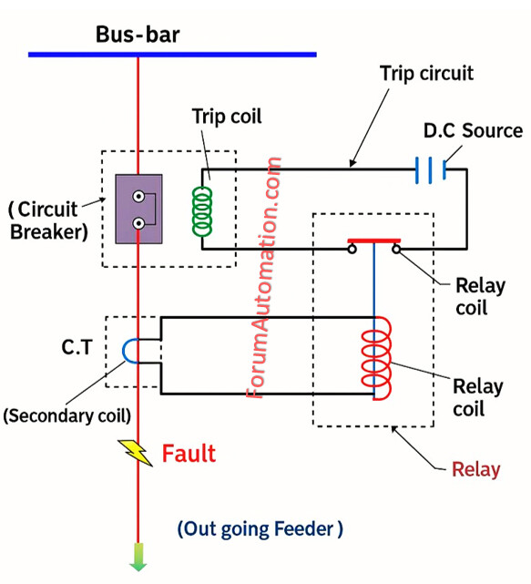

An electrical protection system works away silently saving lives and protecting equipment that all in milliseconds.
Basic components which make this happen:
๐‚๐“๐ฌ (๐‚๐ฎ๐ซ๐ซ๐ž๐ง๐ญ ๐“๐ซ๐š๐ง๐ฌ๐Ÿ๐จ๐ซ๐ฆ๐ž๐ซ๐ฌ)
Step down high current to a value safe to monitor and into the input of the relay.
๐•๐“๐ฌ/๐๐“๐ฌ (๐•๐จ๐ฅ๐ญ๐š๐ ๐ž ๐“๐ซ๐š๐ง๐ฌ๐Ÿ๐จ๐ซ๐ฆ๐ž๐ซ๐ฌ)
Step down voltage to value for metering and protection logic.
๐๐ซ๐จ๐ญ๐ž๐œ๐ญ๐ข๐ฏ๐ž ๐‘๐ž๐ฅ๐š๐ฒ๐ฌ
Essentially the โ€œbrainsโ€ comparing the current/voltage against configurable settings.
When a fault is detected, they send a trip signal to the circuit breaker.
๐‚๐ข๐ซ๐œ๐ฎ๐ข๐ญ ๐๐ซ๐ž๐š๐ค๐ž๐ซ๐ฌ (๐‚๐๐ฌ)
Circuit breaker that interrupt power flow isolating the fault and preventing more damage.
๐๐š๐ญ๐ญ๐ž๐ซ๐ข๐ž๐ฌ & ๐“๐ซ๐ข๐ฉ ๐‚๐ข๐ซ๐œ๐ฎ๐ข๐ญ๐ฌ
Battery provide the required DC energy to instantaneously operate the breaker trip coil even when AC is lost.
Timing
๐‘๐ž๐ฅ๐š๐ฒ ๐ญ๐ข๐ฆ๐ž
Time from fault detection to command time (usually <50mS)
๐๐ซ๐ž๐š๐ค๐ž๐ซ ๐ญ๐ข๐ฆ๐ž
Time from command to contact separation time
๐…๐š๐ฎ๐ฅ๐ญ ๐‚๐ฅ๐ž๐š๐ซ๐ข๐ง๐  ๐ญ๐ข๐ฆ๐ž
Time from fault detected until safety is restored.
It is the coordination between the relay and the breaker that keeps essential infrastructure safe, continuous and protected all automatically.
if you are designing substations, inspecting switchgear (or) analyzing disturbances, having a fundamental understanding of these protection systems is essential.
