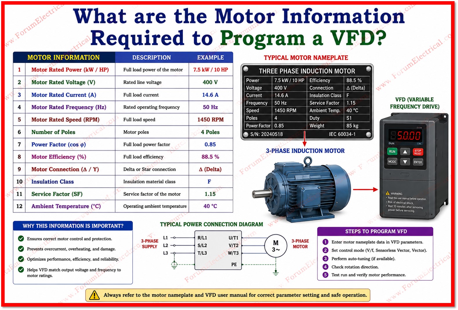

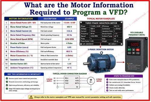

Motor Information required to program a VFD are
1.Voltage - 208/230 or 460V 3 phase .The motor has to be three phase but the input voltage can be single single phase.
2.Amperage - The amperage always needed especially today with high efficiency motors.
3.RPM - This is needed when programming the new VFD
4.Frequency
