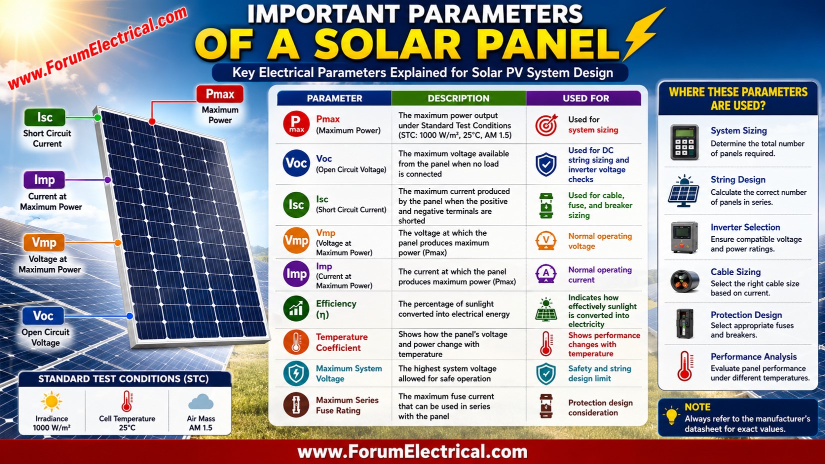

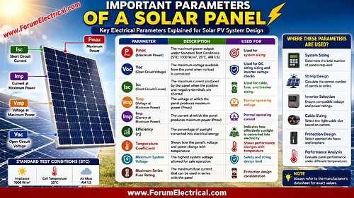

What are the Important Parameters of a Solar Panel?
Understanding the key electrical parameters of a solar panel is essential for designing safe, efficient, and reliable photovoltaic (PV) systems. These values, listed on every solar panel datasheet, help engineers select the right panel, size strings, choose protection devices, and optimize system performance.
Key Solar Panel Parameters
Pmax (Maximum Power): Determines the maximum power output and is used for system sizing.
Voc (Open Circuit Voltage): Helps calculate the maximum string voltage and verify inverter compatibility.
Isc (Short Circuit Current): Used for sizing cables, fuses, circuit breakers, and protection devices.
Vmp (Voltage at Maximum Power): Indicates the panel’s normal operating voltage under maximum power conditions.
Imp (Current at Maximum Power): Represents the operating current when the panel delivers its rated power.
Efficiency: Shows how effectively the panel converts sunlight into electrical energy.
Temperature Coefficient: Indicates how panel performance changes as temperature increases or decreases.
Maximum System Voltage: Specifies the highest DC system voltage the panel can safely withstand.
Maximum Series Fuse Rating: Defines the largest fuse size permitted to protect the panel from excessive fault currents.
Why Solar Panel Parameters Important?
Proper understanding of these specifications ensures accurate system design, improved energy production, enhanced safety, and compliance with electrical standards while maximizing the overall performance and lifespan of a solar PV installation.
