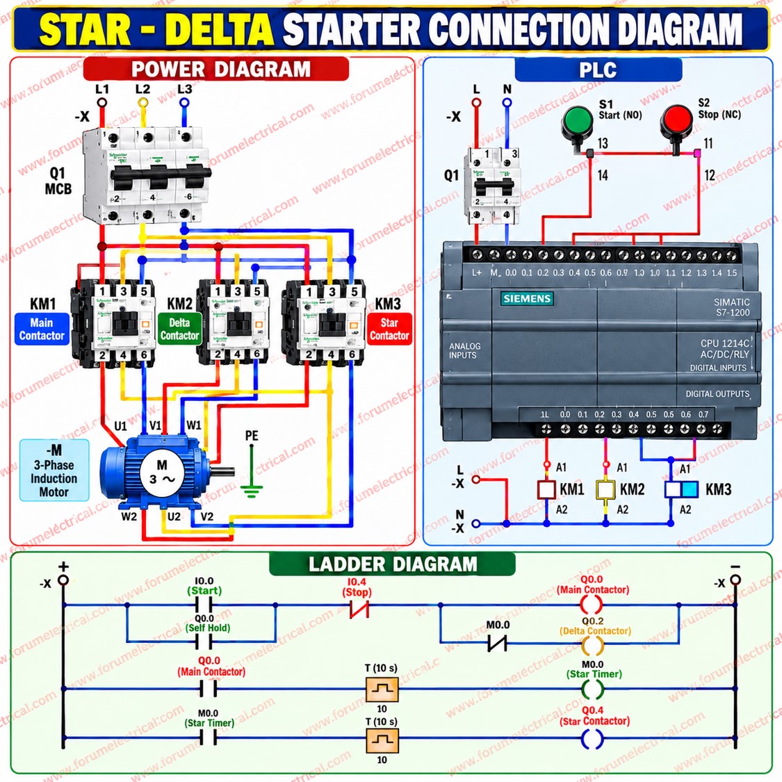

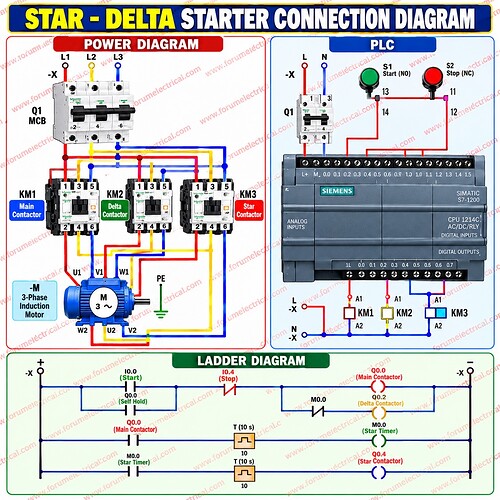

Star-Delta Starter with PLC Control: Motor Starting and Control Logic
Understand the working principle of a PLC-controlled Star-Delta starter used for three-phase squirrel-cage induction motors. This motor starting method reduces the initial line current by connecting the motor windings in Star configuration during starting and automatically switching to Delta configuration after a preset time delay.
Key technical aspects include:
  • Reduced starting line current compared with direct-on-line (DOL) starting.
  • Automatic Star-to-Delta changeover using PLC timer logic.
  • PLC-based sequencing and interlocking of contactors.
  • KM1 – Main contactor, KM2 – Star contactor, KM3 – Delta contactor (subject to the actual circuit configuration).
  • Timer-controlled transition from Star to Delta operation.
  • Electrical and mechanical interlocking to prevent simultaneous Star and Delta contactor operation.
  • Overload protection and short-circuit protection for motor safety.
  • PLC-controlled motor operation for industrial applications. Understanding Star-Delta power circuits, control wiring, PLC programming, contactor sequencing, and electrical interlocking is essential for electrical maintenance engineers, panel builders, and industrial automation professionals.
