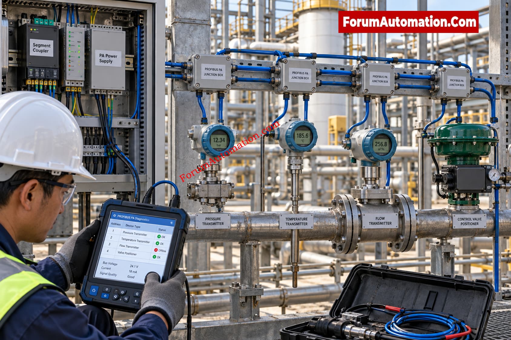

A useful field troubleshooting sequence is:
PA power supply → bus voltage → cable → polarity → junction box → termination → shielding and grounding → device address → configuration.
Use PROFIBUS diagnostic information to determine whether the fault is permanent or intermittent.
