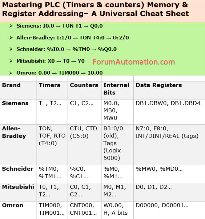

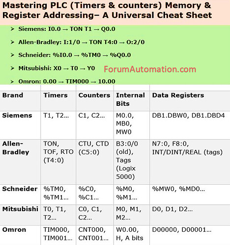

PLC Quick Reference Guide: Simplifying Industrial Automation Logic
PLC Programming across Platforms: Different Brands, Same Core Logic
If you have worked as a PLC programmer, you have likely come across multiple platforms such as
  1. Siemens ,
  2. Allen-Bradley,
  3. Schneider,
  4. Mitsubishi and
  5. Omron.
At first, each system may seem unique with its own software environment, instruction sets, and programming style.
However, with experience, a clear pattern emerges.
Despite the differences in interfaces and terminology, the fundamental principles of PLC programming remain the same.
Concepts like
  1. Logic control,
  2. Input/output processing,
  3. Timers,
  4. Counters and
  5. Sequencing
are consistent across all platforms.
For a skilled PLC programmer transitioning between platforms becomes easier over time. It is less about learning something entirely new and more about understanding how the same logic is expressed in a different “dialect.”
In essence, mastering PLC programming is not about memorizing one specific brand, it is about building a strong foundation in control logic that can be applied universally across systems.
Well said. While each platform like Siemens or Allen-Bradley has its own software and instruction style, the underlying control logic remains consistent. A strong grasp of fundamentals like I/O handling, timers, and sequencing makes it much easier to adapt across different PLC environments, turning platform changes into more of a translation exercise than a learning curve.
