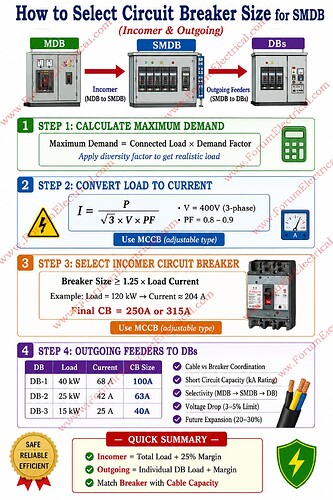

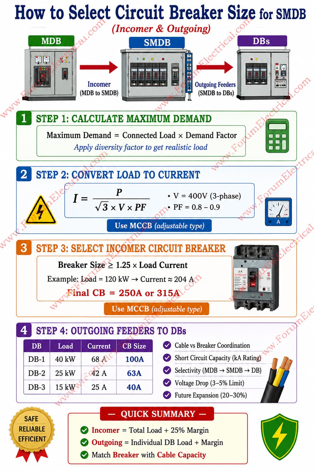

How to select Circuit Breaker Sizes for SMDB?
Many engineers still oversize (or) undersize breakers leading to:
  1. Nuisance tripping
  2. Poor protection
  3. Unsafe systems
Here is a simple and practical method to selecting the right breaker for SMDB (Incomer & Outgoing):
Step 1: Calculate Maximum Demand
Apply demand/diversity factor and don’t depend on connected load.
Step 2: Convert Load to Current
Use 3-phase formula with proper PF (0.8–0.9).
Step 3: Size the Incomer Breaker
Always add ~25% margin
Use MCCB (adjustable type)
Step 4: Size Outgoing Feeders
Based on individual DB loads
Match breaker with cable capacity
Don’t forget these important checks:
  1. Cable vs breaker coordination
  2. Short circuit capacity (kA rating)
  3. Selectivity (MDB → SMDB → DB)
  4. Voltage drop (limit 3–5%)
  5. Future expansion (20–30%)
