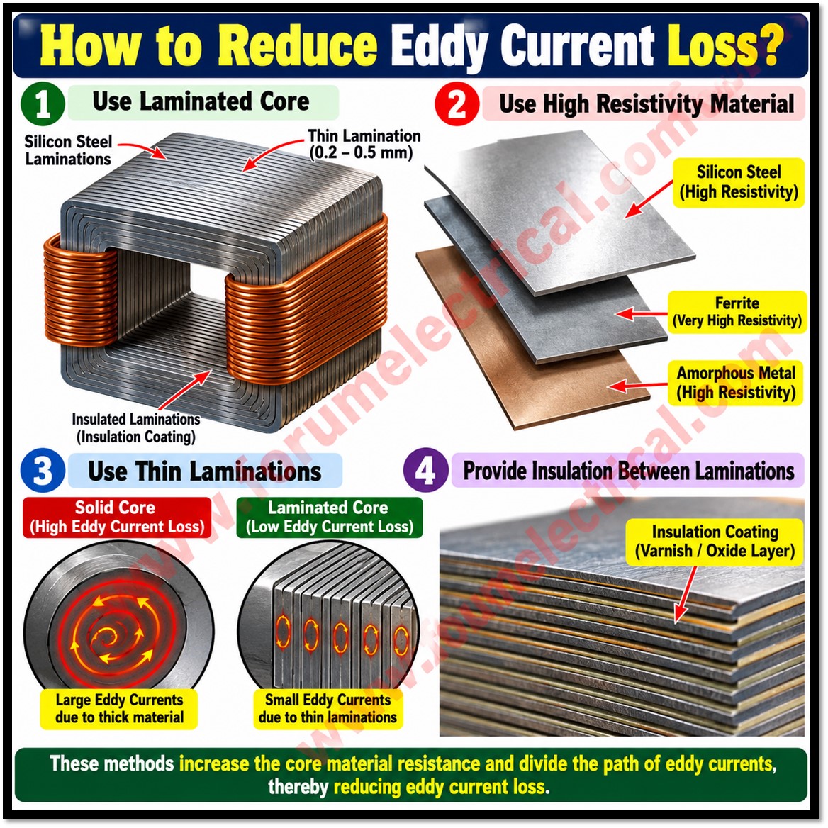

Eddy current losses can be reduced by using
  • Thin laminated magnetic cores,
  • High-resistivity magnetic materials,
  • Proper insulation between laminations and
suitable core materials such as
  • Silicon steel (or)
  • Ferrites.
These methods help minimize circulating currents and improve the efficiency of transformers, motors, generators, and other magnetic devices.
