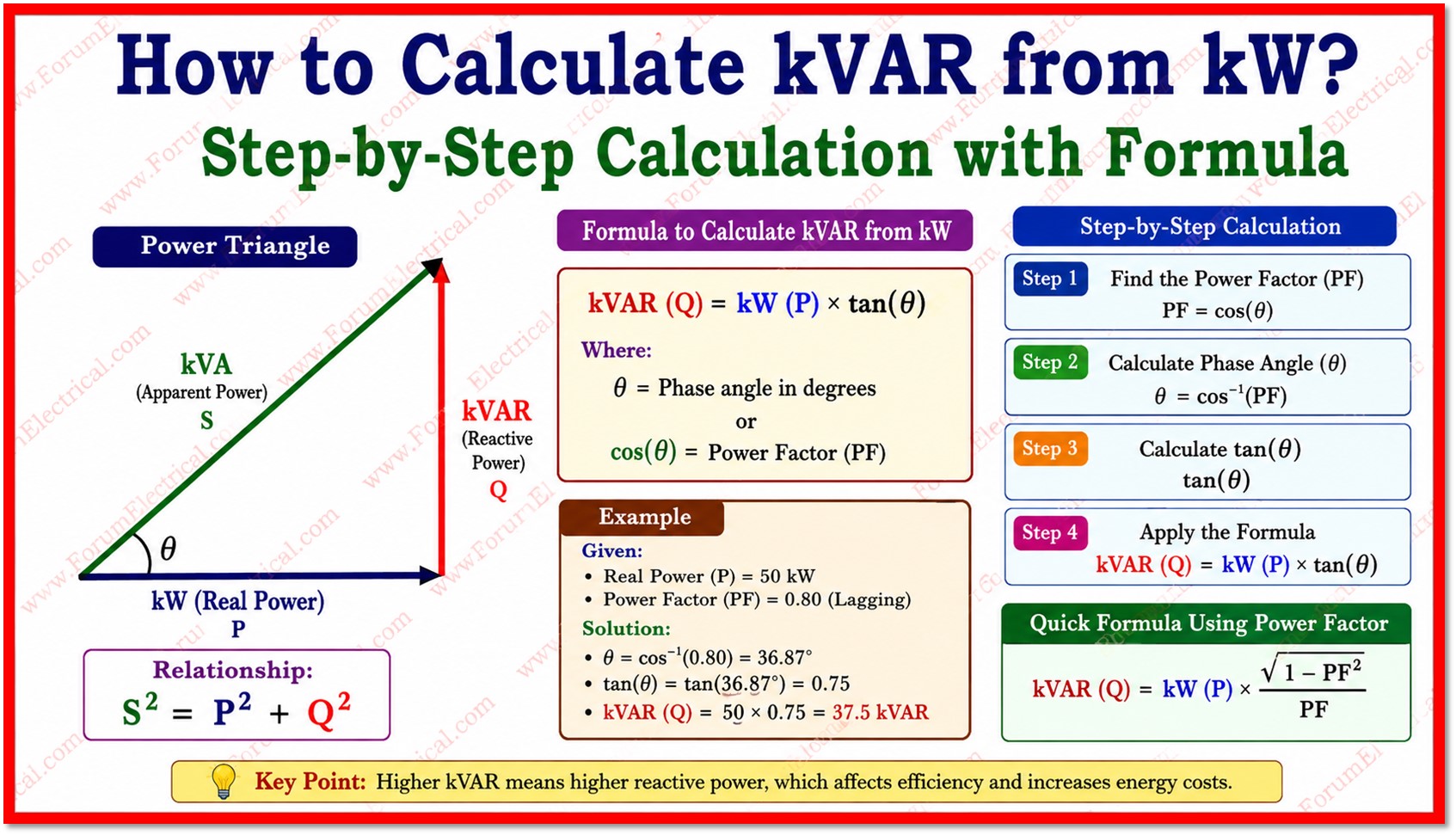

How to calculate kVAR from kW? Step-by-Step Calculation with Formula
Reactive power (kVAR) can be calculated from active power (kW) using the power factor of the electrical system. This calculation is essential for capacitor bank sizing, power factor correction, and electrical system design.
Formula to Calculate kVAR
kVAR = kW x tan(cos−1(Power Factor))​
Where:
  • kW = Active Power
  • Power Factor (PF) = Decimal value (e.g., 0.8, 0.9, 0.95)
  • kVAR = Reactive Power
Given:
  • Active Power = 100 kW
  • Power Factor = 0.80
Step 1: Find the phase angle
Θ = cos−1(0.80) = 36.87∘
Step 2: Calculate tan θ
tan(36.87∘) = 0.75
Step 3: Calculate reactive power
kVAR = 100 x 0.75 = 75 kVAR
Answer: Reactive Power = 75 kVAR
