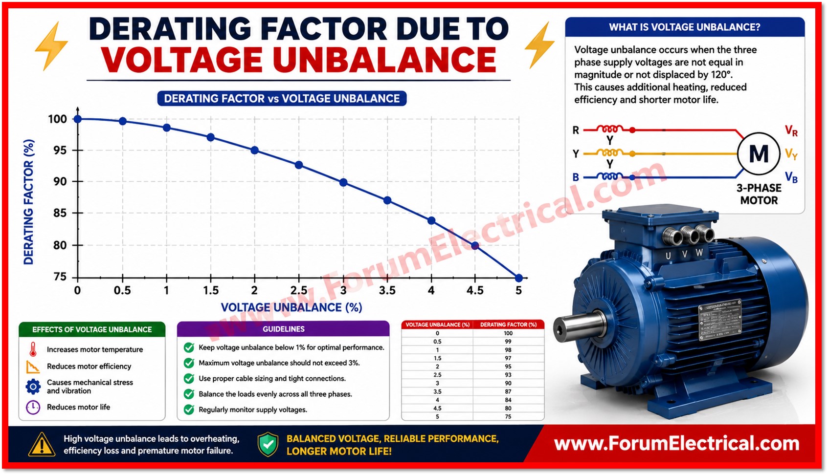

Why Voltage Unbalance Important?
Even a small voltage unbalance can significantly reduce the performance and lifespan of a 3 phase induction motor.
Because current unbalance is much greater than voltage unbalance, the motor experiences excessive heating and mechanical stress.
Motor Derating due to Voltage Unbalance
3% voltage unbalance: Motor should be derated to approximately 90% of its rated capacity.
5% voltage unbalance: Allowable motor load may need to be reduced to around 75% of its rated capacity.
Effects of Voltage Unbalance
  • Increased winding temperature
  • Reduced motor efficiency
  • Higher vibration and torque pulsations
  • Faster insulation deterioration
  • Shortened motor service life
Maintaining balanced three-phase voltages is essential for reliable motor operation, improved efficiency, and longer equipment life.
