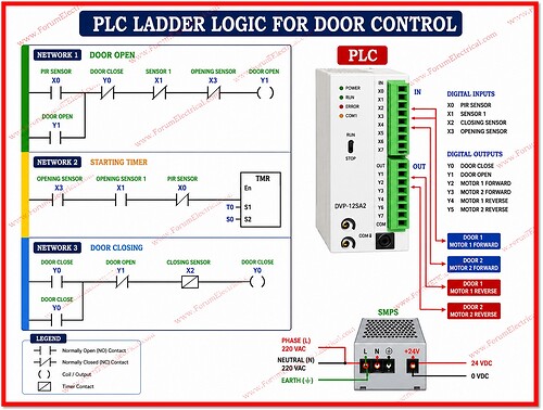

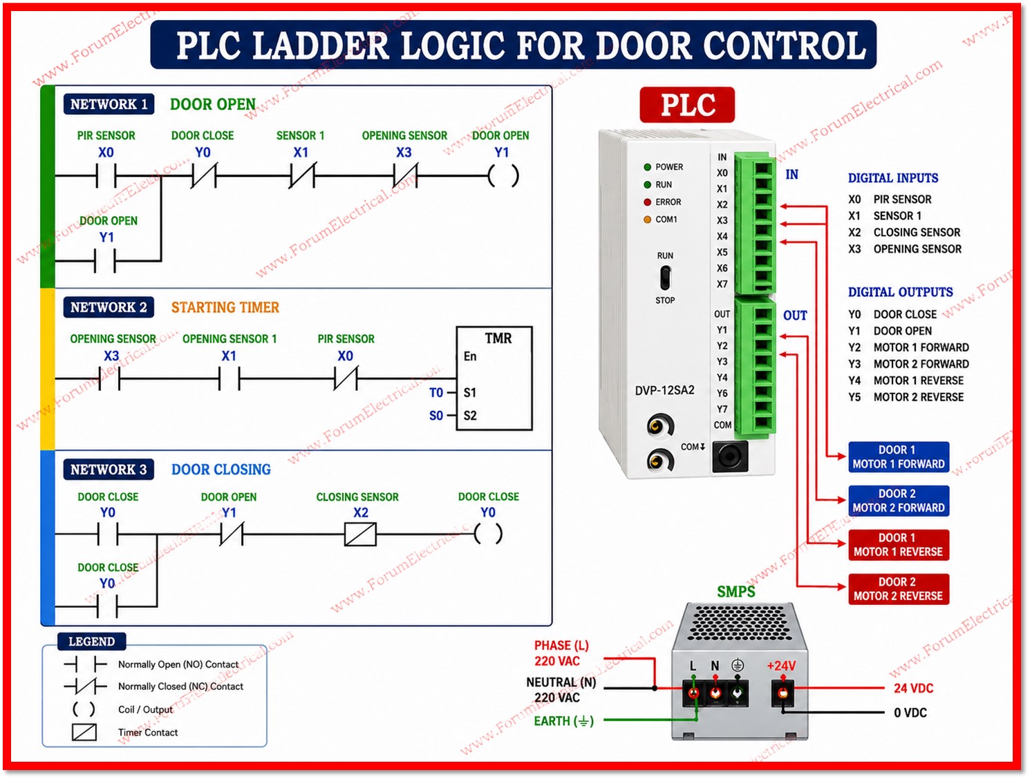

PLC ladder logic programming enables automatic door control by monitoring input signals from
to operate the door opening and closing sequence.
It ensures smooth, reliable and safe operation while preventing unwanted movements making it a widely used solution in industrial automation and building access systems.
