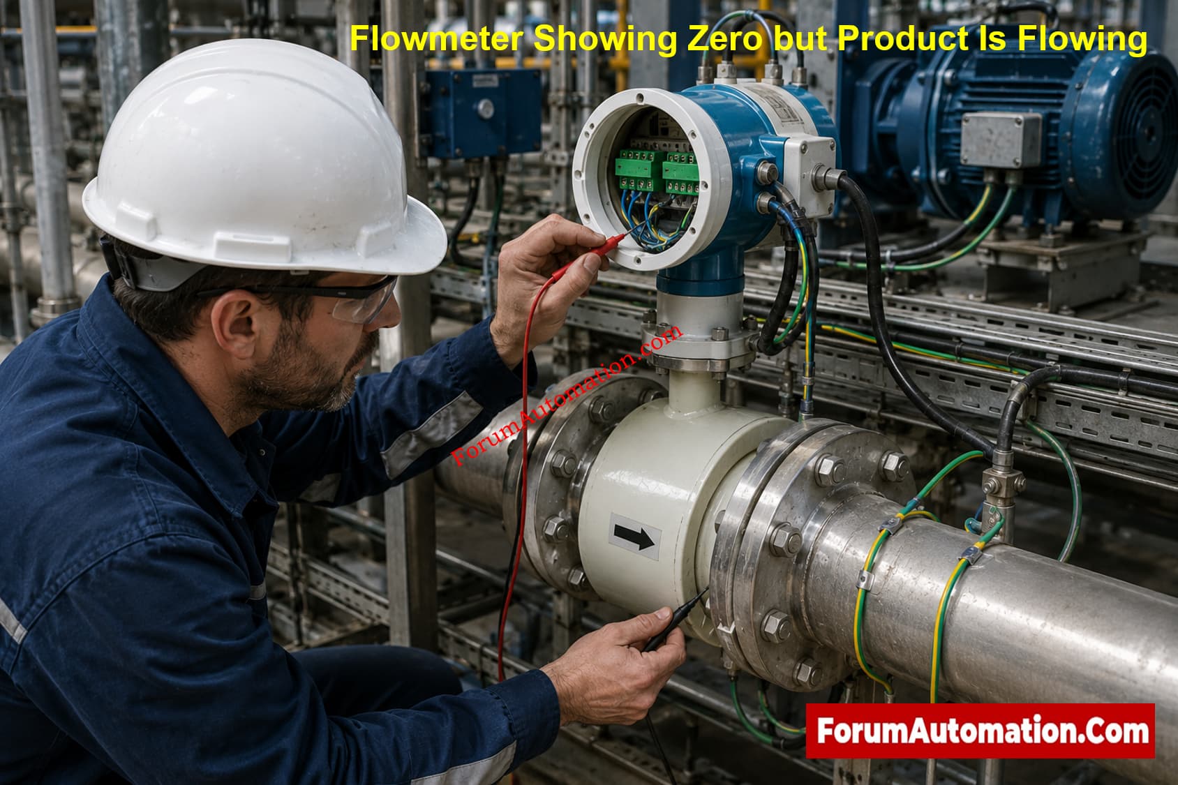

We have a magnetic flowmeter that suddenly started showing zero flow on both the local display and DCS. Operators can clearly see that product is moving through the line, and downstream equipment confirms flow is present. Power supply is normal, and no diagnostic alarms are active. Interestingly, the problem started after maintenance work was carried out on a nearby motor. Could electrical interference or grounding issues cause this behavior? What checks would you perform first in the field?

Typical industrial troubleshooting case – Magnetic flowmeter reads 0% flow, while product is observed flowing through the pipeline. Both the local indicator and DCS show 0 hence the problem is generally at the flowmeter sensor, transmitter, wiring, grounding system or signal integrity level.
Initial Field Checks
Start by making sure the pipeline is filled to the top. Full pipe is necessary for proper measurement with magnetic flowmeters. Then check the transmitter power supply voltage, terminal connections and communication status.
Investigate Recent Maintenance Activities
A very key hint is that the problem occurred right after a motor in the vicinity was serviced. Electrical interference, bad grounding and broken signal cables can have a serious effect on magnetic flowmeter performance.
Grounding and Shielding Inspection
Inspect:
  • Grounding rings .
  • Sensor grounding straps
  • Cable shield terminations
  • Earth connections instrument
  • Junction box wire
A weak grounding system could prevent the meter from recognizing the low-level electrode signals created by the flowing conductive liquid.
Check Signal Cables
Examine cables for:
  • Loose terminals
  • broken insulation
  • Water seeping
  • Wrong reconnecting after maintenance
  • Routing near high power motor cables
Variable frequency drives and motor circuits emit electromagnetic interference which can contaminate measurement signals.
Additional Checks
Check electrodes for coating build up. Check sensor alignment. Check diagnostic parameters. Check process conductivity is within specification.
Most Likely Cause
If a magnetic flowmeter suddenly reads zero shortly after adjacent electrical maintenance, then grounding inadequacies, shield damage, cable disturbance or electrical noise are the first possibilities. It is always a good idea to check the grounding and wiring thoroughly before proceeding to replace sensors or transmitters.
