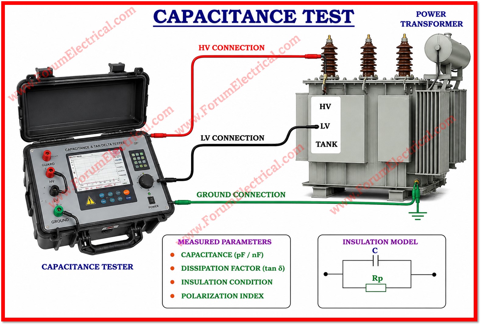

The Capacitance Test measures the capacitance of the insulation system. Any significant change from the baseline value may indicate insulation deterioration or physical changes within the equipment.
Purpose
  1. Verify insulation integrity.
  2. Detect winding movement or deformation.
  3. Identify moisture ingress.
  4. Detect insulation damage.
