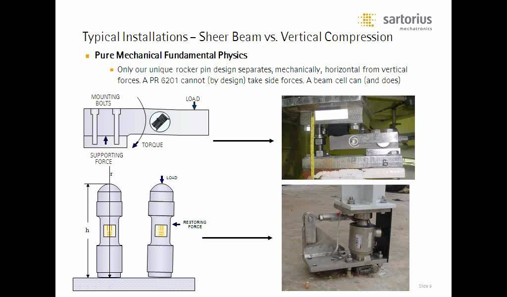

How do you calibrate or check the calibration of vessel weighing system. I believe you can hang test weights off them but how are these generally mounted and are the weights sufficient to make a serious change in output. Any other info about loads cells would be greatly appreciated.
Thanks for the video, I couldn’t find anything in that answers my question though :-(.
